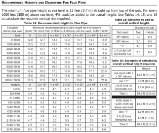

The increase to 8" is not helping. Some stoves need more draft than others and a lot more chimney is required for high altitude installs. This chart is from Enviro for the Kodiak stoves. Click to enlarge.

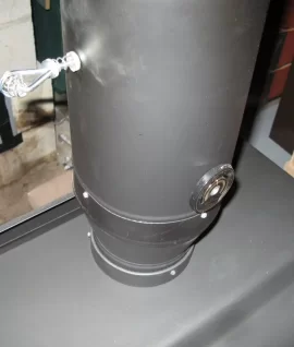

I have an over sized 7" x 11" Masonry Flue with a 8" thimble. I had the Vogelzang Ponderosa with the 6" outlet.
I had trouble feeding the larger flue with 6" pipe so I put an adapter right on top of the stove and ran 8" all the way to the larger flue.
Worked much better as the more volume 8" pipe starting at the hottest part of the system, the top of the stove fixed the poor draft issues.

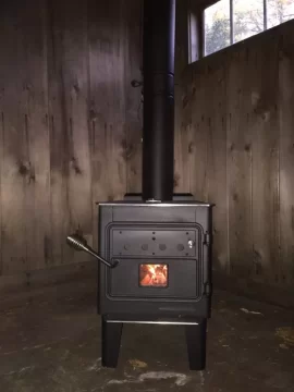

I just put one in a barn that I have and it works great. I only have about 13' feet of chimney though.
Wonder if you got a defective unit.
What temp does yours reach on the top? Also, was your door really hard to close at first until the seal got smashed in some? Mine is REALLY hard to close. Maker said it was the new seal...but its ridiculously hard. My wife can't even lock it entirely.
