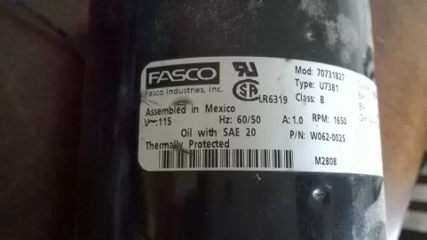

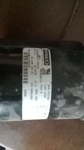

had to take out again today so I snapped a few pictures I don't know about any other stove but this comes apart .. I need the motor. I'll post it when i find it. I'm gonna check out fasco

Could be a Fasco, certainly not a fiasco.
I goggled up 'Fasco Motors' and got about a hundred hits. You do have a search on your computer???
What is the diameter of the motor case and the length (in inches).
