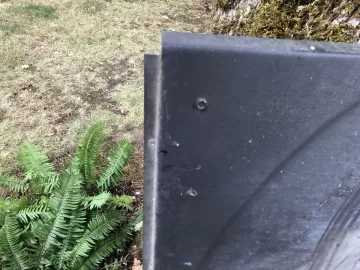

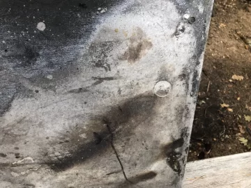

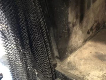

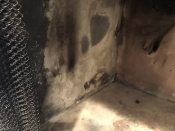

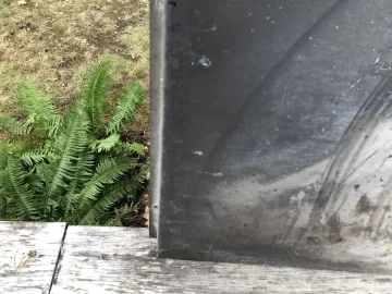

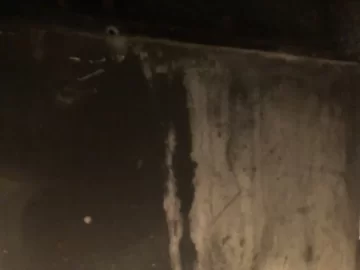

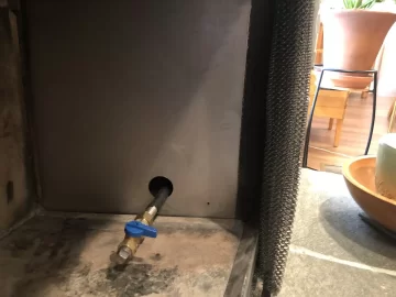

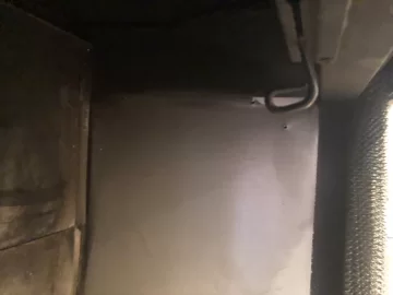

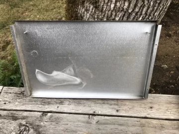

Here are some pictures. The first four are of the panel that was removed. It appears to me that is can be reinstalled just as it was originally. The next two pictures show the hole that goes through the second and third panels. Other than the hole the outer two panels have not been changed, bent or damaged in anyway. The other pictures show the inner panel on the side that has not been modified. I’ve looked everywhere twice and can’t find any markings on the fireplace.

Can you locate the id tag for the fireplace? It should be inside the front lip somewhere
Were there any refractory panels in the fireplace originally?
There are only two metal panels: one has been removed to allow the hole to be drilled and one is in its original position. I don't believe there were any other panels. The fireplace is just as it has been since the 1970s and has been used to burn wood. Unfortunately no name tag.
