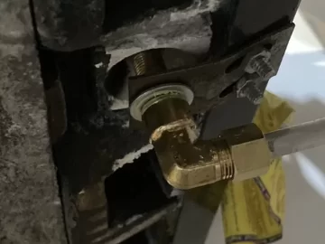

- the hardest part is the bray injector, which is a brass 90-degree elbow fitting with a ceramic tip. This is where the gas comes out and goes into the burner tube when you turn the stove on. The injector has been out of production for decades and are the hard part to find. The part that you need for NG is stamped "82-900" on one side and "bray" on the other (the LP part is "82-300"). You can either try to find someone to trade with; or, you can modify your existing 82-300 to have larger holes. LP 82-300 orifices have 7x very small holes; the NG 82-900 has 7x larger holes, approximately 2x larger. I talked to a natural gas stove service tech guy and he said to just drill my 82-300 with a 1/16" drill bit and that would do the trick; luckily I was able to trade before having to do that. If you do drill, you may want to use a pin vise like this one: Amazon product ASIN B07FJ6VD2P to make the holes slightly larger, then try it and see if the flame looks OK - worst case it will just have a small flame or run inefficiently, the unit won't explode if you make the holes a bit too small or too large (you may need to adjust your Robertshaw's regulator or the air shutter to compensate). If anyone ever reads this, send me a message on this site and I can try to measure the outlets on my 82-900 NG injector for you to know the stock size of the outlets. You can also try contacting this site http://www.ignus.co.uk/index.php?main_page=product_info&products_id=172 because they appear to sell the 82-300 LP injectors (they do NOT have the NG ones, I asked) so you could always buy a "spare" if needed, but they can be hard to get in touch with from the USA.

I pulled everything out last night and found that I did indeed have the 82-900 (NG) injector. I am going to try to block off half the holes temporarily while I keep my fingers crossed regarding sourcing a 82-300 (LP) injector from the UK.
Only questions now is - Where is the Air Shutter that is referenced?

So, it looks like you have a different unit than the Radiance 2240 that I (and a couple others) have. Yours appears to have the same internals - the pilot & thermopile assembly & the injector are identical - but the layout is totally different and this really looks nothing like what I have. On my and 87yotaman's Radiance 2240, there is a metal tube that the injector pokes into, and on the side of the tube is a screw that you can undo and turn to open and close a slot which is what is used to control the amount of air that's being mixed in.
Yours doesn't appear to have an air shutter or that inlet tube at all - it looks like your injector is just pointed straight into what I assume is a pre-cast burner assembly or something.
I wonder if you could experiment with taking a piece of sheet metal and using it to try to block off some of that "hole" that the injector goes into, effectively reducing the amount of air that is going in. Imagine a throttle on a simple engine, right now your throttle is wide open so you are getting a lot of air with your gas, and if you can create some kind of a restrictor plate to limit the amount of air, that might give you better combustion (perhaps without modifying the injector at all, I'm not sure).
This is all just a guess though - on my unit, there is just a screw that you undo and a little tube-with-a-slot that you turn which opens or closes the slot and lets more air in or out (opening or closing the throttle, effectively).
