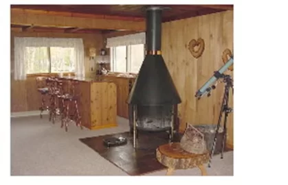

Time to upgrade. This 32" diameter fireplace is on the 1st floor in a ranch style cabin near Lake Superior and is supplemental heat to a nat gas forced air furnace. It produces great heat, vents just fine, warms the room from 50 to 78 degrees very quickly, when outdoor air is below 0ºF, but goes through a ton of wood as you can imagine,. Looking to upgrade to a more efficient freestanding stove. Little about the cabin/space being heated: appx 16'x28' ish room w/8' ceiling. Cabin has full basement and furnace is in the basement. I burn a mix of seasoned hardwood including maple, ash, oak. I would like a stove that warms fairly quickly, has decent burn times (8 hours or so would be fine) presents a nice view of the fire for entertaining, and has a large firebox to accept 20" wood length or so. Looking for some suggestion on models, would like to do this for under $1000 stove cost but will consider going above budget if it will be the last one I have to buy.
Honorable Mention: This fireplace was purchased from Sears around mid 1970's. It included a swing out grill/grate that clamped to a leg that you could position over the coals, as well as a rotisserie kit! Plans include relocating the stove to an outdoor location under a detached garage overhang to use as a social area.

I was going to recommend buying a used pre EPA stove to avoid having to deal with the need for "perfectly seasoned" wood. But, they usually don't have large viewing windows, which is something important to you. There are a bunch of guys on this forum with more experience dealing with stoves in this price range - I'm sure they will be here to help shortly. Good Luck!
Is it heated at all when your not there? If you need to heat it from sub-freezing temps, I'd be looking at a big one. Englander 30 NC, maybe.
If you don't mind using the furnace to warm it up, you could get by with a smaller one. PE's True North TN19 can be had for under $1k. Our place in northern Michigan is similar in size. It would take days to get comfortable with just the stove, but once the furnace helps to get the place warmed up, it rarely runs.
Don't forget you'll most likely need a new chimney, and possibly a hearth pad depending on the stove you choose.
