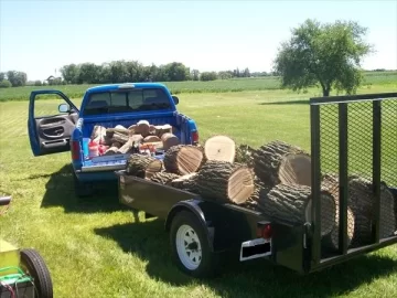

So if he was collecting maple (taking a middle of the road weight for green maple) at 4390 per cord - 1/2 of a cord is 2195 pounds evenly distributed in the bed of a truck, there is a problem? Dunno, maybe my truck is a manly man truck or something, but it pretty much laughs at 2000 pounds evenly distributed in the bed. That is actually just about the right weight to level the truck out instead of its normal butt up stance.
You would really hate to see how I load my trailer.
That was green White Oak.
I load the same way its only going to take so much weight why stack
That doesn't look like White Oak to me - maybe Mossycup Oak /Bur Oak, but I guess that wasn't your point. So how many cords in the trailer?
Gar-own-double-teed White Oak. A little over one, by my guess. I don't stack until it gets staged for winter burning (in an old wash house next to the house) so I rarely get a measurement of any load.
Want to hear something pretty amazing? If you look at the size of some of the rounds on the bottom, they get pretty big right? Yeah, that was only one section that split from the tree. The trunk is still standing and supporting the rest of the tree. It was (is) a big sucker.
