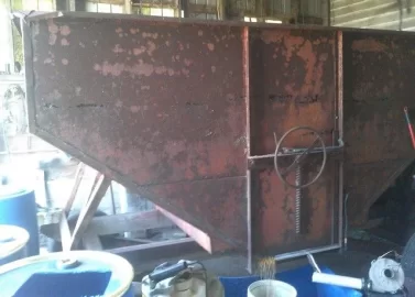

Picked up my Corn for the year, Close to 2 ton. This will be mixed with pellets until it runs out hopefully it will last until the end of March 2015.

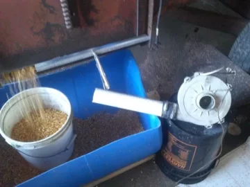

The fan i use for cleaning is from a high efficiency gas furnace, It is also used to clean the vent pipe on the pellet stove. I clean the corn in the workshop to keep the mess out of the house,
We sweep the floor in the shop with the fines when we are done it's great sweeping compound!

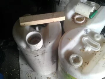

The funnel is a 15 gallon barrel cut in half to fill the 30 and15 gallon barrels.

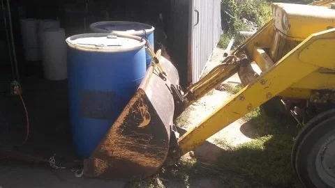

We cut large holes in the 50 gallon barrels and just dump it in the corn then reseal with a piece of plyboard and a few screws.
We can drive into the basement so a tractor is used to move the barrels
Any ideas on how to streamline the operation is appreciated.

Every time I think I will streamline, I throw another bucket threw the screen and 20 seconds latter I give the horse her ration and head for the house with a full bucket. Maybe tomorrow:)
Oldtimers kicked in forgot the pics of the funnel for filling the small barrels.

Will the bucket of the tractor fit under the hopper chute? Would building a second smaller hopper high enough off the ground to fit the large barrels under help? Fill the raised hopper and straight to the large drums. An old horse water trough (the 200 gallon galvanized) is about the same size as tractor bucket, and cut whatever size hole flows the corn at the desired rate.

What is the tractor Arti?
Case 211b manufactured sometime in the 1950's about 30 hp. Those 2 barrels are approx 350 lbs apiece and it handles 2 of them with ease !!
The corn that I picked up is fairly clean, however it is like all feed stuff it has a lot of what is called bees wings in it, because that is what it looks like.
It will burn or go thru the stove but anytime that u move or pour the corn it floats in the air like a red cloud.
My idea was to blow it outside and have less mess in the house, one of my stove's is in the living area so I'm trying to keep it cleaner.
Out of 2 ton of shelled corn I collected about a 2.5 gallon bucket of this residue. The fan also blows out the corn husks and silk which could wind up on an auger and jam it although I've never had that problem.

I run corn through a 1/2 inch screen over 1/4. Pretty much anything that goes through the 1/2 is safe for the feed system and if its smaller than 1/4 inch is horse and pheasant feed.

Mainly cleaned with the blower, I sort of watch it coming out of the wagon and get any long stems / sticks out by hand although there isn't much of that in there.
Caution, if you use a blower inside a lot of fines and chaff will blow around in the air it's not a problem for me in the shop but it would really make a mess in the house, that is the main reason I use the fan when it comes out of the wagon is to keep the chaff out of the house..
