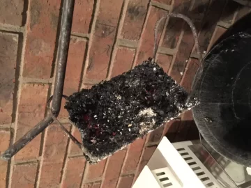

Corn stove and clinker problems
Not that I'm not enjoying this conversation, but back on topic, IT WORKED! :)
Many thanks!!!!
  • [Hearth.com] Corn stove and clinker problems
Many thanks!!!!
I usually try to provide factual information, usually.
No problem. Corn burners have to stick (pun intended) together...lol
It won't always come out in one piece but most times, it will and coathangers are cheap and plentiful. Take the bisquit outside to the garden plot and wack it with a hammer, retrieve the hangers and reinstall...next time. 4 hangers bent work all the time.
Was recommended by another corn burner to keep the clinker from getting like a rock. The older corn varieties didn't seem to have as much of an issue. GMO problem? No access to lab anymore to try and figure out the makeup of the clinker.
Something I'm pondering as well. Will GMO corn react differently during carmelization and clinker formation...I don't know, in fact, I'm not sure what I'm burning. It's old crop (last year's) corn so I'm presuming it's pre GMO.
