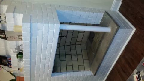

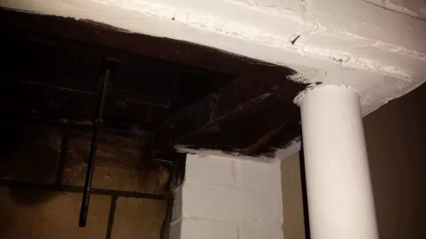

[Hearth.com] Corner Fireplace Help! [Hearth.com] Corner Fireplace Help! Hello, first time post for me. We bought this 1955 split level a few years ago that has 2 fireplaces. One is standard, but this second one is extremely awkward and I need help to make it usable. I've done a level 2 inspection and the good news is it has never really been used. Clay tiles look great with a bit of water damage on the top. Now the bad....
I've uploaded a picture so you can see how the fireplace comes out of the wall. The flue then bends sharply at probably a 45 degree angle and then shoots straight up. The opening to the flue is tight and the sharp bend causes the smoke to collect and come inside the home. Our neighbors have the same fireplace and have all told us it is unusable for wood burning due to the smoke collecting and the backdraft.
We would like to put a wood insert as we like it over gas. My question is how or what can we do to accomplish this? Can a wood insert use a metal liner with a fan to push the smoke out?
Can we get rid of that metal post? It moves slightly but I don't know if it's just a cover for a beam inside? Has anyone seen or dealt with this style of fireplace before? What are your suggestions to retain this to wood? Can we use a metal liner with a fan without an insert?
no no fans
I have built a side wall on them before and put inserts in but if your flue is that bad it might be really hard to hook up a liner it is hard to say with out seeing it in person

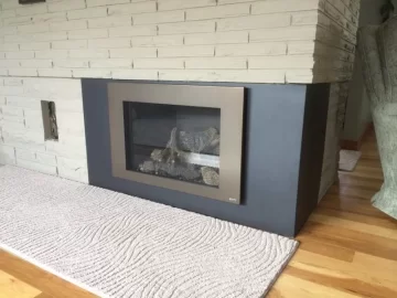

So doing something like this is out of the question?
That looks to be a zero clearance fireplace you could not retro fit it into yours. I am sure you could get a custom set of doors made but that wont make a badly designed smoke chamber and flue any better
Dang that's some bad design work. Corner fireplaces can work if properly constructed but seldom do you find one that is.

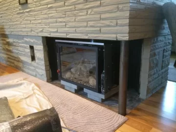

Been lurking for awhile, but came across a solution a little while back so I figured I would share. Take a look at fireplace xtrordinair. I came across this on their facebook page, and found out they will make custom panels for their inserts. I believe both wood, and gas units. If the flex vent can fit through the chimney it should work just fine.

That is a unique fireplace, never seen one with a steel corner post. Do not remove that post.
Good luck with making a wood stove work there, I hope it comes out well.
Just to clarify. The corner post is indeed structural. It can be removed if you wish to brick in one side. A small bottle jack strategically placed is all that's required. You may find a one sided insert that clears that post or you may wish to gain a few extra inches by removing it.
