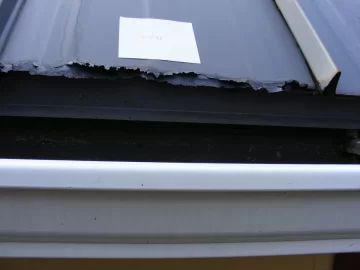

I have a standing rib PVDF metal roof installed in 2012. The cut ends of the metal roof panels (a total of four) below and adjacent to the stovepipe, have badly corroded. Additionally, there is a small area 4' below the stove pipe where the colored coating is flaking/peeling off. There is no discoloration or staining to the roof, just the effects of corrosion. I wont go in to the round and round with the metal roof supplier, they concluded I had a fire in my rain gutter. The short story is that they will provide new metal roofing if I pay the labor. My roofing contractor stated this is from run off from the creosote, however he hasn't seen this occur before.
I would like not to repeat this. [Hearth.com] Corrosion to metal roofAll of that brings me to my question. What can I "wash" my metal roof with to neutralize the acid effects of the creosote, and at what frequency?

Is there visible creosote on you roof? I have a metal roof and have never had a problem. The end of the metal panel does look like it got hot and boiled the paint off but hard to tell by looking at a picture
That doesn't look like corrosion to me either; it looks like is got hot. Does the roof have the same appearance adjacent to the chimney as you mentioned?
There was no fire. I could post additional pictures of the inside of the rain gutter, and flashing that don't show any evidence of fire, but that's not why I'm here. My roofing contractor has already confirmed there was no fire, as I contended all along. He, the contractor, was able to get the metal supplier to admit privately the was no fire. They won't admit this to me, or discuss how to clean the roof of creosote to avoid a reoccurrence (since they deny this as the cause). They will supply the metal if I cover the labor.

There is slight staining that I can remove with a damp rag, what I can reach (expand picture in first comment to see). I buy seasoned wood only, burning the oldest wood only. For example, this year I bought 2 cord of wood that I will burn the winter of 21, 22. This year I will burn wood that was purchased in 2019. I pretty much burn Douglas Fire exclusively so I doubt MC is a problem.

I have heard of a product called "rust guy" that when sprayed on rust neutralizes it. I have no experience with it but it's worth a look. After looking at your pic again it's obvious there was no fire. Your drip edge and gutter seem to be in good shape directly below the corroded panel.

Thanks for the replies, and ideas for rust prevention. I have a four roof panels similarly effected as the one shown in the picture. The one I posted is the worst one. The supplier will furnish new roofing, so my interest is in neutralizing any corrosion due to creosote exposure in the future. Thanks.
