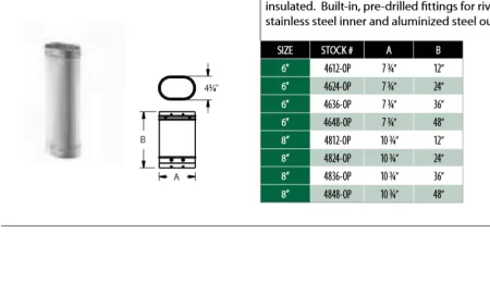

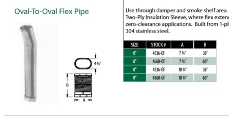

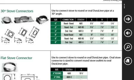

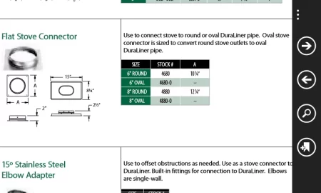

will any of these pipes or connects work?
[Hearth.com] Country Comfort 325, with a weird oval flue [Hearth.com] Country Comfort 325, with a weird oval flue [Hearth.com] Country Comfort 325, with a weird oval flue [Hearth.com] Country Comfort 325, with a weird oval flue
Thanks to you both, begreen and Wisneaky!
Wisneaky: Yes. One of the ones listed in your first picture would fit the outlet perfectly. Is there an adapter, where I could go from oval to round? or is it best to stay with the oval all the way to the top of the chimney? The pictures of the adapter plates for the top of the stove: do they fit all stoves? we just drill a hole where the current bolt holds the oval plate in place?

Yep. I think they used oval because of the low clearance of the front of the fireplace. I'm wondering if I got a stove-top to round pipe adapter, at 30 degrees, and then a 30 degree elbow to point back up the chimney, it might fit. definitely not a straight shot up!
Thanks so much for the links. I'll start looking through now.
Hello Wisneaky!
That should work, I'd measure it out to make sure. They have all the specs listed.
