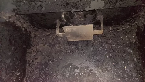

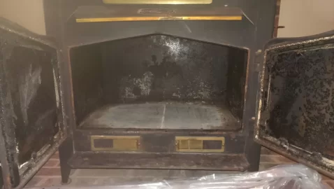

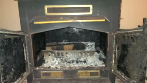

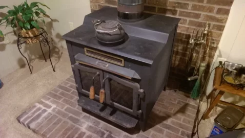

The house we purchased came with a Country Flame model CMD, freestanding wood stove. We had the chimney cleaned during the house inspection. At which time I believe the sweep told me that a fire brick was cracked. Many months later, and a few months post inspection, including months where the stove was in use, I get around to cleaning the flue. I just finished building the wood shed so I was pretty excited to move on to phase two...getting the flue and wood stove ready to burn.
On the roof, do the chimney sweep thing, all looks good. I come down, get ready to clean out the stove itself and the flue inside the house, and I see that there are no fire bricks, and there is a grate...in the stove.
My neighbor was puzzled, I am puzzled.
My questions are:
1) Does anyone know anything about this model of stove?
2) Could it be that no fire brick was ever in this stove, and I could be imagining what the sweep told me?
3) Can I use this stove with the grate, and no fire bricks?
4) Can I add a layer of fire bricks to the floor of the stove only? There are no metal clips of any kind to hold bricks vertically on the side walls.
Any help would be appreciated. I have attached pics, thanks!

That looks like the CAT holder in pic #4 without the CAT? Welcome to the Hearth.

I thought that could be a cat holder as well. I guess burning without one would be fine though...thoughts?
There is no "bypass" mechanism anywhere on the unit. Everything I have been reading in regards to cat stoves is that they have a bypass mechanism. Also, there is no air intake in the rear as in the BBF model, only in the lower front as shown in the photo. The grate above the doors is a chamber that the blower comes through.
The previous owners were definitely burning with the grate in there, and judging by the build up on the walls I am guessing there were no fire bricks in place either. Would there normally be some sort of clip or shelf to hold the fire bricks on the side walls if bricks were recommended/required?

I would think the sides would have a metal bracket for holding the brick.
Yeah, nadda...nothing. No clips, or brackets on the sides.

My CF02 only has the two bottom bricks, I plan to fit side/back bricks if possible.
Not all older stoves came with bricks, this one looks like it didn't. Can't say I am to crazy about that design with no bypass, I can see why they ripped out the cat, but as you can see it is a creosote factory now, you will have to burn that stove pretty hot to keep it from looking like that and plugging up your chimney with no cat in it.
You can always add bricks to it, not sure how much good it will do if you burn it with no cat as the bricks help to hold in the heat to help the fire burn cleaner at lower temps when using the cat.
Btw, that stove already shows signs of being over fired quite a few times.
You could clean all the creosote from the insides, maybe gently with a sandblaster. Line the inside with firebrick and fire it up. If it were me I'd remove the stove and test it outside, you might check into a chimney liner for your home. I used (4) pieces of cheap 6"x36" pipe for a makeshift flue/chimney on the driveway at my shop to test my CF02. Good luck with this, by testing outside you have the stove removed already in case you find another stove.

I know the previous owner had been using daily. What are the signs of over-firing?
We saw it in operation when we looked at the house prior to buying, everything was toasty, no smoke in the house, and the previous owner did have CO2 plugs in, in th eoutlet near the stove as well as a combo smoke/CO2 in the downstairs and upstairs hall.
I dropped 60 bucks on firebricks today, bad idea? Magnum got back to me via email this morning. They forwarded me a scan of the oldest manual they had, it seems they came with "floor" refractory bricks only, which I guess explains the lack of clips or brackets on the walls. I tried to upload but its to big. My plan was to stand up a row along the walls( only one row stood vertically ) and hold them in place with the floor bricks. Any thoughts?

The crazy thing is the "whiteness" on the sides is not really apparent in person but the camera really brings it out. I wouldnt be surprised if it was over fired a bit, it seems like thats pretty common. I am glad you mentioned it though, I didnt even notice it.

If you fit the side bricks in first, the bottom ones should keep them in place. Clean everything you have access to. Try the stove out but keep an eye out for any issues. Keep us posted! I still need to pick up some bricks.
The picture that shows the gaskets is out of focus and I can not tell. Do the dollar bill test on them, they might be ok.

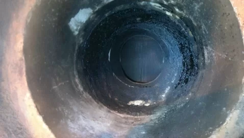

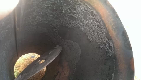

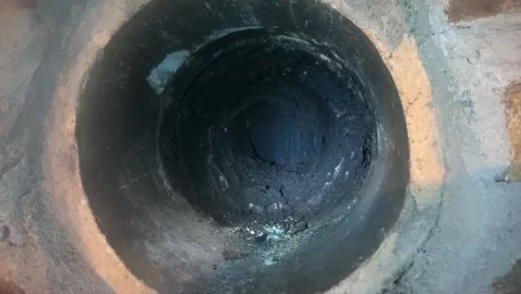

I also have an update with pictures after cleaning the inside of the stove and the pipe and elbows through the wall to the flue.
930 dreamer: like your stove this one has the bottom bricks! The grate threw me off. I assumed because they were using a grate that under all that ash was metal...not so. There are indeed two large fire bricks, see photos.
Now I have 60 bucks in bricks, do I use them as planned on top of the existing two bricks? Is there any advantage to this? I was thinking that maybe having the bricks vertical on the sides could help, any thoughts?
I can always return them to the local ACE Hardware.
I cleaned the pipes and inside the stove as best I could with a wire brush, all of the large creosote chunks popped right off but there is still some small bits clinging to the metal. The pipe passing through the wall was the worst, the flue was definitely restricted, not sure how often the previous owner took everything apart and cleaned this section. The flue running up to the roof was not to bad, but compared to this pipe and the inside of the stove, my guess is he didn't spend as much time on it. However as previously mentioned by mellow, maybe its a creosote machine and he was cleaning it. My guess is he got to the vertical flue more often though as it was much cleaner than the stove, the elbow, and the pipe through the wall.[Hearth.com] Country Flame Model CMD, new owner, new burner...just plain newBefore Cleaning
