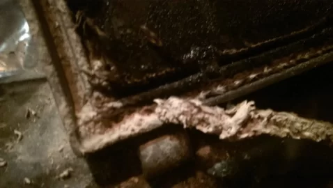

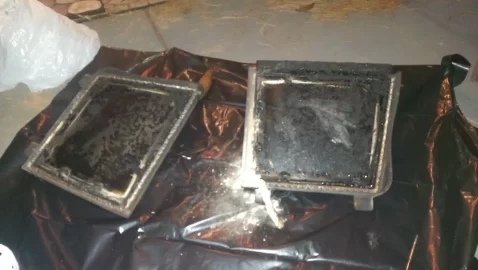

    Ok, so door gaskets replaced....
    Doors off...and gaskets were pretty bad.

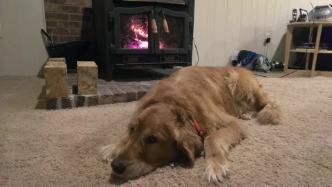

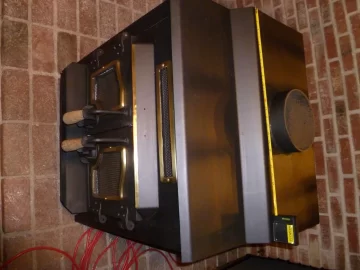

    Also got my first burn in...dog was loving it.
    Glass gaskets could probably use a replacement as well but the screws are a mess so I think I will hold off until after this season. Stove got up to temperature, we ran the blower off and on, worked great and heated the whole house. Thanks for everyones help so far! IMAG1003.jpg
