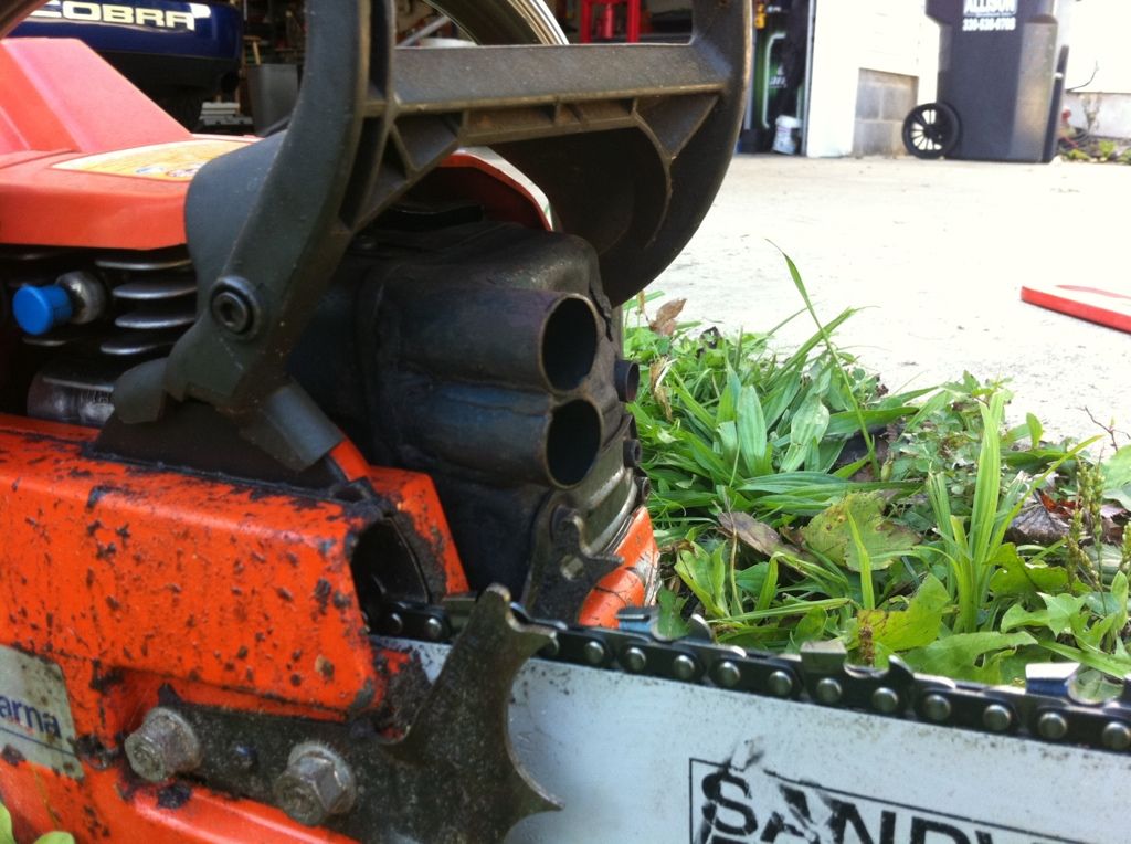

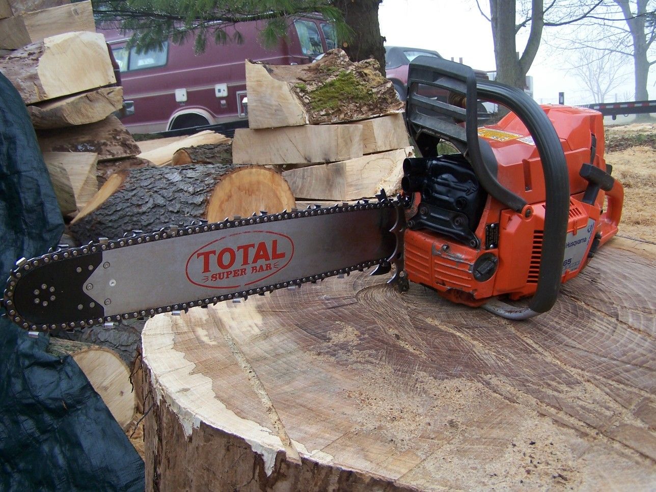

Well, now that I know about this adapter, I can start using my 20-some Stihl bars on the husky....thanks for the heads up! I have yet to mod the muffler on the 372xp yet, but I plan on doing so. Any pics of your muffler mod?
Dex is right, you're gonna fit in nicely around here!
here's my favorite....although the easiest way to to remove the muffler, remove sparkscreen, pry up on the deflector and get in there and diegrind the hole out.

Nice lil' chunk of Black Cherry just behind the bar in last pic :cool: Really like that 'double barrel' muffler mod on that 372....I just bought a 2nd OEM deflector & firescreen & attached it on left side of my 288XPW with self tapping hex heads.

Yeah the 281/288 deflector is the other easy way. I do them on the stihls on the drivers side as well as the Dolmar 6400/7300/7900's.

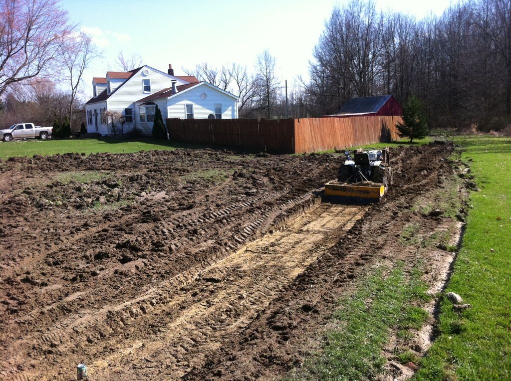

might have seen an episode of gold rush filmed last spring as I was regrading my property...got some wierd looks from the locals..... ya know, new guy in town, junk everywhere, cutting trees and fencelines down and then digging for gold?!!
