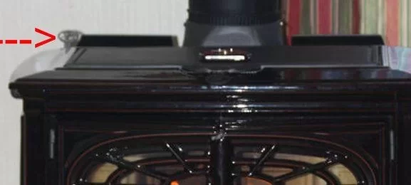

We had a thread along these lines a few weeks ago regarding Leyden bypass issues. My Leyden is new this year and may have that matter fixed. Below is where i copied and pasted from that earlier thread. https://www.hearth.com/talk/threads/23254/
Hi Woodburn
I have seen similar reports of short burn times with the Leyden in the hearth.com stove reviews. I did ask the dealer about that issue and he reported that there was a problem identified with the older models and there was a fix included on mine.
The bypass baffle had a problem of creeping open which would shorten the burn time. Perhaps this could also lower the stove top temps as you have observed since the heat would be escaping out the top past the open baffle. Somebody with knowledge about this will have to tell us. Anyhow; Travis did rig a fix for the matter.
The pictures of red and black stoves are of early model Leydens found on the showroom floor in October, 2006. Note that on the left hand side of the stoves’ rear heat shields there is no device visible in the area above the baffle closing level. For the benefit of other readers the baffle closing lever is not visible in the 2006 pictures but it is located on the left side near the back.
The other picture is of my daughter Samantha pointing out the new baffle closing lever lock device on my stove. My stove was built in September, 2007 according to the tag found on the back. The locking device is clearly visible from the front of the stove.
I would hope that this locking device would be available to all early model Leyden and Arbor owners. I think this would be worth bugging your dealer about.
