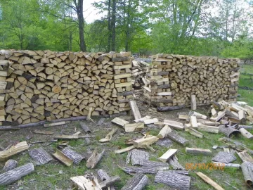

We got by for many years without a woodshed and had no problems. When you stack though, be sure to stack off the ground. We just cut saplings in the woods, lay them down and stack on them. We stack 4 1/2' high and that usually shrinks to 4' by fall but we most generally split in March or sometimes in April.

Thanks, Backwoods. I live by Grand Rapids. Putting saplings/branches down is a great idea. I was using pallets, but those are harder to come by.

This is a picture I took last spring while stacking but you can clearly see the saplings laying under the wood. Works great and cost is just about flat zero.
