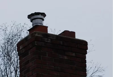

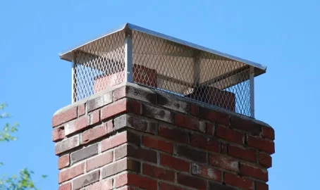

I had the mushroom cap originally as it was part of the liner package. I had that ripped off this past spring and went with a dual cap setup. I don't think even a hurricane can take this off as it's set with mortar screws.

Stejus, mine looks just like your new picture - except yours is clean! I couldn't believe how much black, cinder-like creosote crusted up on the top (and fell in chunks on the chimney crown and my other sealed flue), and also coated the screen. The good news is my liner itself had just a few cups of fine brown powder.

I almost chose the black version of this cap for the very reason it was going to get black. I chose stainless because it has a lifetime corrosion guarantee where the black painted version is not stainless and did not have a lifetime corrosion guarantee. In due time, it will be black I'm sure!
