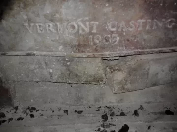

Hello Friends!
Can you please share with me if this cracked brick is a danger or burning problem-ie, excess draft,lost heat etc? Many Thanks
[Hearth.com] Crack Firebrick a Problem?
Unfortunately, it's likely a sign of whats behind the scenes. I would guess there are other problems behind that panel. What model do you have?
It is a vermont casting 0044.......my chimney sweep said he didnt think its a problem--actually shrugged it off- but I respect you guys here more!
Thanks
As long as it stays intact it should be fine
I say a problem. Reason being fire going up under that cast piece above it instead of up the flue.
That exactly what my chimney chap said, but i trust you guys more here! thanks...should i try to replace myself without removing unit? like just try to pull out and "shove" in there? is that even possible? i know brick stores near me must sell firebrick. Thanks
Thats what I was thinking, but what harm can be done if that is so? start a house fire? lost heat? can I live with it?

Clean the crud out from behind the brick first and shove it back in place. Burn a low kindling fire after you put the stuff in there to dry it out and set it.

Ok, so its safe to pull the cracked(right side one) out completely? then clean like you said,shove in and cement? thanks!
Beats the hell out of burning in the thing like it is. >> Of course a brick is like three bucks at my stove store. But that looks like a long strip of refractory. A Vermont Castings specialty. Chit ya can't find anywhere.

Temperature is more important than amount of flame. Just burn some kindling for thirty minutes or so and that should cook the moisture out of the furnace cement fine.
OK, THANKS BUT CAN i GO AHEAD RIGHT INTO A REGULAR FIRE RIGHT AFTERWARD? iT'S COLD HERE oops caps sorry--its cold here and wanted to run the insert most of the day -but also wanted to address the problem...whats best to do? thanks!
Yep. Let'er rip.
Give it a half hour of low heat and then burn like ya always do. You do the low burn to dry it so that you don't have to wait twenty four hours.

Hello My Brother Bart.....many many thanks for all your wisdom ,support and advice---you are SPOT-ON! on all your rec's....sealed my cracked firebrick, ordered th correct gaskets and have gotten bettter overall temps,,,,,,,,much less "leakage thru broken bricks" and better temps,,,,,,,,, I am just trying to be realistic and figure if my old VC 0044 can REALLY heat a 2000 sq ft home with poor insulation and vaulted ceilings-----maybe I am asking for too much-huh? it takes about 2-3 hours to get to 500-600 degrees internal box temp(thru glass).. ANY IDEAS? Please!
