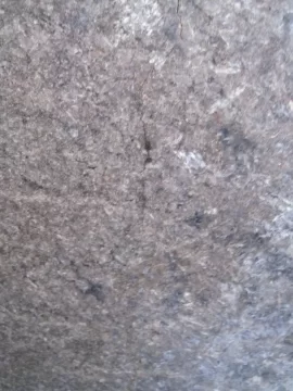

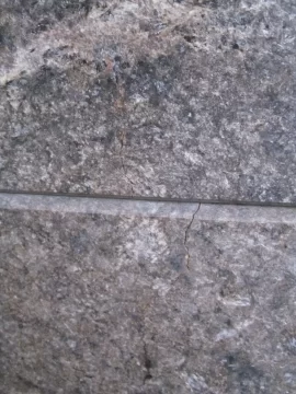

Cracks In The Stones Of My Hearthstone Homestead.
donmattingly
Jun 17, 2009
72
Southern,NH
I saw them starting to develop last year. I have owned this stove for 4 years. No complaints other than these cracks. They appear on the side and are not visible unless you are looking for them.
Pretty sure it is my fault for getting the stove too hot too early in the burning season.
Here is my question. Should I be worried?
[Hearth.com] Cracks In The Stones Of My Hearthstone Homestead. [Hearth.com] Cracks In The Stones Of My Hearthstone Homestead.
According to the stone stove makers, cracks are normal. So long as they aren't leaking creo out or sucking air in.
I have been frequently lighting matches near the cracks while the stove is going to see if there is any draft or leaks. So far, nothing.

I have an old Woodstock Classic that has several cracks in various panels of the stove. However, on the Woodstock the entire stove appears to have two layers of soapstone on every surface. Since none of the cracks on the outer layer of stone appear to match up with any interior cracks it doesn't seem to affect the performance of the stove in any way that I can tell.
