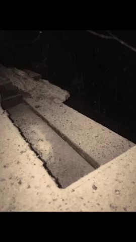

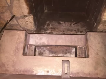

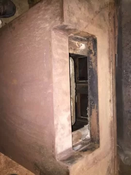

This is the old craft stove also a pic of the back that probably needs the rectangular to round adapter. The other pics are of the old damper inside my fireplace. The last pic is after cutting it out the possibly getting and SS liners down the chimney to the stove. What do you recommend?

If it were me I would sell the stove and put in a modern stove for the reasons explained above. But some folks love these old stoves and that's ok, if it can be made to work safely. You'll have to start by measuring the chimney tile liner dimensions above the smoke chamber to see what will fit. If it's a 12x12 the bigger liner should fit ok unless there are confounding factors like a change in dimension, an offset, etc.. Then you need to figure out if there us a stock rect. to round adapter available or if one has to be custom made.
Is the rect. flue opening on the top of the stove or on a sloped rear side? What is the size of the flue exit hole?
The flue exit on the stove is 15.5” x 6.5” and 2” deep. It’s on the top back side of the stove. My chimney is approximately 12.5’ from top to top of the stove. 10.5”x10.5” wide.

Yes, that might need a custom adapter, probably with a gasketed seal on the vertical face.
