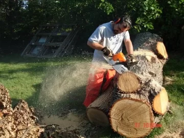

unfortunately it happens often unless your willing to run with 42IN. bar or master it.Reach over the top side and this will set your kerf or groove if you run the saw at the top of the wood to a 90 degree you will not have a problem matching the back side of the wood.
Thats the start of the cut now run the saw til its 90 degree with ground then work your way down, it will end up one stright line all the way around. It is possible to do more than 2 times the bar length
