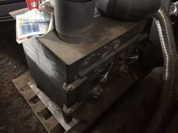

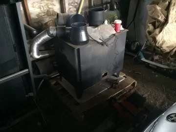

I'm looking at buying this stove for dirt cheap but I was looking for some information about it to see if it's worth the drive to get it before I commit. Measurements purported to be 22 3/4"D x 31"W x 28 1/4"T
Here are the photos the seller texted me. Not very helpful I know but it's what I got.
Thanks for your help!
That is a different one, from the back of it, it looks newer, it appears to the cutout for a blower that mounts there and blows air across the fire box and out the series of holes in the front of the stove.
But when you look at what look to be cast iron doors, It looks older with the two turn in air controls, to damper the fire.
It may just be the way the pictures are but when you look at the starbucks cup in the first pict it appears the plate steel top extends way past the back of the stove, but when you look at the starbucks cup in the next picture the top appears to just over hang the stove slightly
Also note that the sides show large amounts of discoloration on both sides, that is a sign that stove was run really hard, hot enough to discolor the paint.
