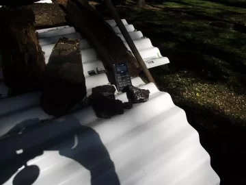

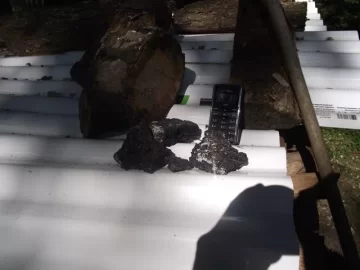

I guess only you can say. If your wood quality isn't the best (my wasn't right off) and you are running cool, could be pretty often. Once a month is not out of the question in a more standard install, I'd check it every 2 weeks at least at first. One thing I know, I would not want to have a chimney fire in your situation.
If you can inspect yourself or better yet do your own sweep do it. I have not swept my myself but it's 30' to the ground. I found this though after putting a cord of less than perfect but not horrible BL through my setup.

ok not mentioning the things that need done ie: ceiling support, bolted to floor, outside air kit, and ground wire. i think i have found why it was getting so much creosote so quick, by the way i did remove pipes and did have a bit of creosote built up. cleaned it real good and bought a magnetic stove pipe thermometer and have taken some notes.. here is what i found. i think my catalyst is not working correctly so i made some adjustments on my flu and thermostat setting. the settings i was using before my fire would actually go down to nothing and coals would stop glowing and come back on about a half hour later and repeat this over and over.. and stove pipe (single wall) would drop to 190-200 then back up to 275 or so while it was burning.. now i think i have a sweet spot.. i have the flu on stove opened about a 1/4 to 1/3 way open and thermostat set to where i have a constant slow burn with red coals and a constant stove pipe temp of 300-310 ...
do you think the cool pipe temps would have caused the creosote build up so quick? and if so would this sweet spot i think i found make it a bit better as far as cresote building up so fast.. of course i am gonna check it again to make sure but just wanting your expertise advise..
