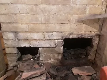

i am wondering if this caused my most recent creosote issues. when my so-called chimney sweep was here in november, they cleaned out the basement opening to my chimney & left it wide open. i had it stuffed with insulation & covered up. they pulled out the insulation & left it all the way open.
can anyone tell me if this might be what is causing the current issue with my chimney?
(i believe past issues were caused by my old stove not getting hot enough & often smoldering)
Yes it definitely would cause a problem but it also tells me your liner is not installed properly
It tells me the bottom of you liner is not sealed off which is probably one of the major causes of your creosote issues
where would the clean out be if the bottom of the liner is sealed off? (sorry if this is a dumb question...i don't seem to understand chimneys)
Well either your liner would be extended down to the cleanout with another tee there where it is either mortared in and has a gasketed door. Or it has a tee snout extending out with a cap on it. The other option is just a tee cap on the tee just below where your pipe enters and you vacuum out the dirt.
okeydokey. so i maybe i can find someone who can fix it so without putting in a whole new liner...or am i just screwed?
They may be able to reuse the liner. But if its already full of glazed creosote it may not make sense to
