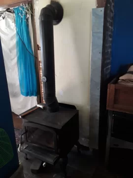

one photo is the new set up. though for the first 3 years i had the cookstove with a longer stove pipe. it was always getting creosote buildup in the pipe & chimney entrance. i cleaned it regularly. this one has no build up in the pipe or inside the flue at the stovepipe entrance point so far. i'm guessing the clog is somewhere near the top of the chimney.

  • [Hearth.com] creosote build up
