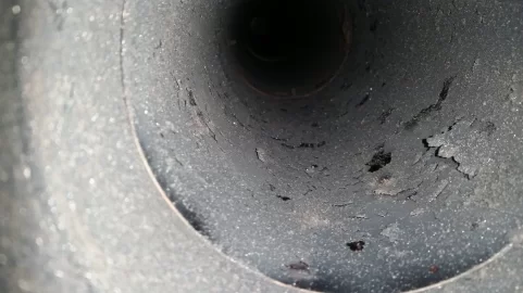

Ok I took the pipe attached to and just above the stove off for a quick look for now. It was definitely creosote that I heard. The pipe all the way to the cap looks to be covered in a layer of flaky cteosote. It does easily come off so I will clean it this week when I'm off work.
Is this amount of creosote to be expected, or is this worse than it should be?

Looks like it has been burning cool. There would be almost none if the flue was warmer. What temperatures are you folks running your Madisons at?
Yes, if the stove is not run hot enough the internal flue temps can drop below the condensation temp for creosote. Generally, until the wood is in the coals stage you want the flue to be at least 250F. A higher flue temp is better if the connector is single wall or the flue system is very tall.
