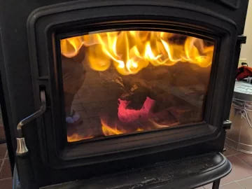

First, the picture you showed here is with only coals. There is no risk of creosote production at this stage of the burn cycle.
Second, in the other thread, the second picture you showed - the one with the air down at 20%, showed secondary combustion occurring above the wood. You just closed down the air a little too much and/or too soon.
[Hearth.com] Creosote help?
Reactions: kennyp2339
..for a second i felt a huge weight of relief when i read what you wrote :)
but that picture was taken at just the right time. seconds later all the flames went out completely so i definitely didnt have a secondary burn
i may be confusing what a secondary burn actually is. perhaps with the F55, the flame doesnt actually shoot out of the small holes?
