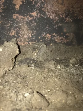

[Hearth.com] Creosote in damper area [Hearth.com] Creosote in damper area [Hearth.com] Creosote in damper area I had my wood insert re-installed last summer. Wanted to really do it right and super safe, which I wasn’t sure about with original install.
Well, during the reinstall, the installer said that removed a bit a glaze from the smoke shelf area. Was glad he was diligent to do that.

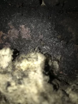

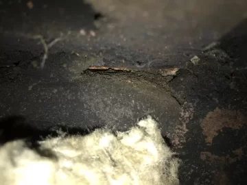

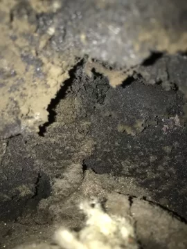

I’m a very safety conscious guy, and Today I decided to remove the surround recently to take a look at the area bc I’m thinking about do a block off plate as the installer just stuff roxul in the damper area. while the parts visible upon first glance like smoke chamber and right above the damper appear very clean, I decided to take some pics with my phone looking down into the damper. This is an area hidden from plain view. I found bit of non-shiny buildup, in most areas around perimeter of inside of damper. It seemed like the heaviest buildup was inside the damper in the corner of the firebox. It appeared that there was a fair amount of old mortar that could make it look like the buildup was more than it is. A little tough to figure out what was what in this area.
I have a jotul insert inside this masonry fireplace. The buildup in damper area is about 6 inches above top of insert. The buildup is mainly on the bricks which make up facade of chimney and no so much on actual steel damper. My liner is wrap insulated and insulation starts about one inch above the damper.

It was a fireplace damper that installer left in place. The buildup is down inside the damper-mainly on one course of bricks around perimeter of smoke shelf area. The chimney has been swept a bunch of times since I have lived here when I was using the open fireplace as well when insert was installed. This area I’m talking about would be next to impossible to clean without removing that old fireplace damper. You can see the difference- just above this area is clean as a whistle.
I will report back with installer’s response to my request that he fix it. I’d like to think it’s hard to argue with my pictures but I’m guessing he will try. I paid good money for the install. They insulate liners as standard practice which I thought set them apart from many of the other so called pros in my area.
