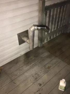

More than once, we've had threads of various kinds about black soot and creosote leaks etc. But in many cases it appears to be the installation and exhaust plumbing that contribute to the issues.
So if you can describe, or best yet, post a picture or two of the exhaust plumbing, it would help. Since you did not perform the spring cleaning, it could be that the set time with normal build ups has collected condensation moisture and ran down the plumbing. I'd first give your friend a couple bags and see how it goes before I'd give away that many pellets that may not be the issue.
I'll post pics of th plumbing later. It was professionally installed with oak. Had no problems for the first 3 years so I doubt it's the plumbing. If it builds up with other pellets then I have an appointment on 11/10 to have them come look at it. I have had no problems with chow in the past. This time I bought them at the end of the season on clearence and there was water under the weather covers. Dried off the bags and the pellets weren't swollen so I kept them. Gaskets are the only other thhing I can think of.

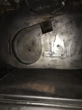

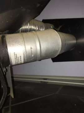

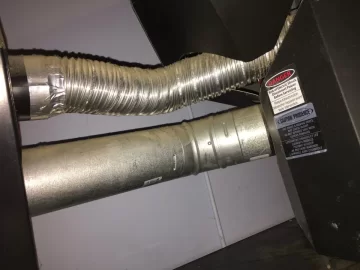

I finally got the fan off. Carb cleaner worked. I'll post pics of the stove after removing a lot of it and pics of the plumbing as requested before. It hasn't been cold enough to run the stove hot long enough to test much. I did run a couple of bags of clean energy pellets through it on stove temp a few days ago with no issues so far. They were actually burning about 50 degrees hotter than the Chows. Oh and I didn't mean to come across as being a major critic of their pellets. I'm pretty sure I just got a bad batch that Home Depot had sitting outside for months. One more reason I'm going to pay more and try the local guy for a season.

Good for you getting that fan blade off. I would get some anti seize on the shaft and the set screw. You could still salvage the pellets.

In image 0050 and not to burst your bubble, but I think Harman specs an outlet temination to be 7 ft above a walk way. I could be wrong about that without looking it up but I think so. Not that that has anything to do with your creosote issue.

Yep, that's about as simple of plumbing as you can get. Almost same as mine.

At first I saw your outside vent thinking why not straight out but then realized you needed clearance up off of the deck. As Bio said anti-seize everything you can. My fan is stuck on my PC45 but it is fine. When the motor goes I'll have to cut it off. I have blasted it and it has been soaking and I may try to get it off before I start it this year but if not I'll just go on about my business.
I went ahead and anti-seized everything on the P68 and when I do my good cleans I take the fan blade off and redo it all with anti-seize. Works like a charm plus I get a better clean too.
