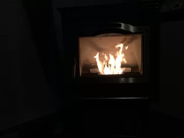

Decided to burn some other left over pellets I had. I don't get a nice cone shape to my flame. It's kind of wide, and a little lazy in my opinion. I wish I could post a video. Here is a pic of my flame anyway. What do you think.
To me, depending upon what setting you had it on, that flame does not look all that bad. Maybe a little low on air, but a real lazy flame will be darker in color and much taller as well as not as active. Lazy flame looks like a match flame. But I am looking at a still picture and my observations from such should only be taken as my OPINION, not factual advice to act upon.
