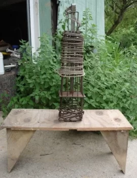

Below is a pic of the two essentials I use for cleaning the chimney. Ooops, left out the third, the ladder.
  • [Hearth.com] creosote
