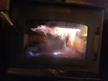

Been running the stove all day at about 400 STT. I add a single split about every 3 hours or so and get a clean secondary burn with each split. I use about 6 splits a day to maintain even heat in our living areas.

To each his own I guess but? Can't you simply fill the stove completely with a full batch and call it a day?
I'd like to, but I have not been able to keep the stove burning clean at about 400 with a full load. It always climbs to 600+, driving everyone out of the house. Suggestions?
Yaaa. 600+ is not a surprise. I didn't know you were having a overheating issue. Turning the air down considerably sooner than when you have been is my only thought on keeping your STT down with a full load. Possibly worth experimenting.
He's running a noncat stove. They burn clean by burning hot and are purposely built to prevent the operator from burning low and slow.
The spoon feeding is a reasonable solution to regulate room temperature when a clean burning temperature with a full batch of fuel is too much heat.

A full load in a non-cat is going to get it warm. I have found that cutting back the air aggressively helps. With a 50% full firebox, I can hold the stovetop to under 500º yet still have a clean burn. The other part of the issue is the stove location, room size, floor size and openness of the floor plan. If the stove is in a small well-insulated space then it is likely to overheat the space until it gets very cold outside. Moving the heat out of the space can help within reasonable limitations.
