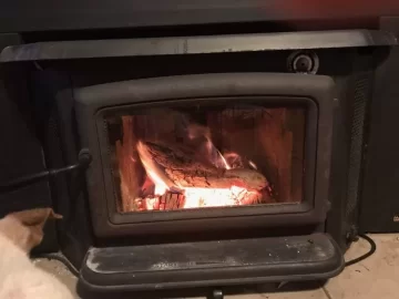

Just poked the fire to help settle down for a coal bed tonight, and this happened..... look past the fire to the back of the box. Crumbling fire brick.
PE Pacific, D1 version. Steel insert, installed in an interior masonary chimney. Can I still run it???

hard to tell from the pic but its mild out, let it go out and get a replacement.

Yes, you can keep running it. When the stove cools down, remove that brick and swap it with one not wearing as much. Maybe one from the floor? Rear bricks tend to go first. It's where I got my first cracked brick. We need to be gentler slamming in wood in a hot stove.
Can I run it on "low simmer" for the next 2 - 3 days, then work on changing the bricks out?
I have left overs from a box I bought 2 years ago, should be enough :)
Yes, that'll be ok.

Yes, our stove is the same age and it has a couple cracked bricks now. I will be swapping them out with floor bricks during the summer.
I'm going to try to hold off until spring. After this weekend, we're back in the 50's during the day, and 30's at night..
The last time I did bricks, the baffle was down. It was a lot easier to do.
I also packed the empty space with ash ;)
