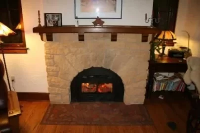

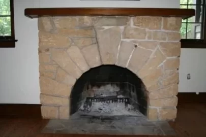

We finally finished a custom install of a Lopi Declaration in our 1927 English Tudor home and I thought I would share some pictures. As you can see from the first picture (before install), we had an existing inefficient fireplace and a hearth that was in need of cleaning after 80 years of use. I wanted to get more heat out of the fireplace but wanted to preserve the arch in the hearth. So, I wasn't interested in using a stock Lopi stove front and rectangular surround that would have covered the arched stone. I also wanted the stove to be as unobtrusive as possible, but still provide some heat. After much research, I determined that the Declaration was the best stove for our situation.

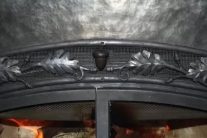

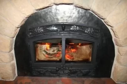

I cleaned the stone (TSP and elbow grease) and repointed all the mortar. I tore out the existing floor stone, cut out some hardwood flooring and reinforced the floor. Next, I found a local tile artist who made by hand and installed custom tile that are a random pattern of individual tile tree leaves (see photo). I then installed the insert (blockoff plate and 35' of pipe up our massive stone chimney) and insulated the whole cavity around the pipe with perlite (I have posted messages on this in the past). Finally, I found a very talented local blacksmith who made the custom surround with hand hammered steel plate and a oak leaf and acorn motif (to match the tile). The hammered black iron matches other original ironwork in the house (railing, light fixtures).
I am a woodworker, so I turned some ebony acorns on my lathe to serve as a knob for the upper bypass and as handles for the doors. Finally, I wanted to hide the fan wiring, so routed it under the mortar between the stones to a wall mounted control behind the mantle so it wouldn't show.
The stove heats well and we have cut our heating bills in half.

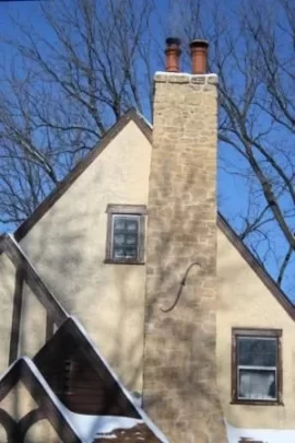

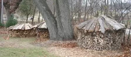

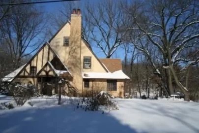

I forgot to mention that I also installed a couple clay chimney pots during the chimney install that I had salvaged from a house demo.....pictures attached. You can also just barely see my Holz Hauzen in the far right corner of the picture....I also post a picture of the series of HH I constructed this year....they are disappearing fast....its 0 degrees in Madison today. Bob

Ummm, yeah, that's a big arse tree in that bottom pic! What is that?
