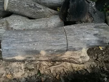

Nice work. Your stuff looked a little aged. Dead or been felled for a while?

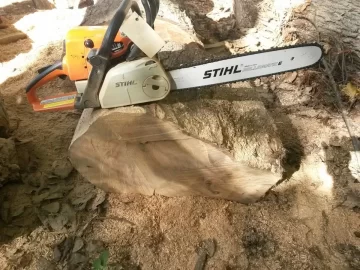

Standing dead for several years ,a tree service hauled it here instead of the dump where they would have to pay money.You get lucky often if you stay alert.New blade was smoking.
Looks like its partially petrified ;)
Chain too tight, bar not mounted properly.....

Check your autolube system. Is the chain wet? Did you use any bar oil?
Chain is wet a hair too tight,new blade and bar everything seems okay now . Am cutting the last round.

That's a chainsaw killer right there. Good work! Awesome wood to have in the stacks.
