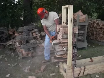

TreePointer, Bingo! Thanks! It was a post from Zap from a long time ago that I was referring to. However, in one of the links above, TreePointer posted this picture of an H Frame Saw buck, and that is exactly what I was talking about. The one Zap built had a back to it which served as a guide for the new desired length, but this version will work just as well.

This works for me....got this idea from the forum here...mine is much larger than the one I saw here...I load it up and cinch it down with a ratchet strap and grab my 660 and let it rip...I didn't want to play around with a arm full
[Hearth.com] Cutting Down Splits... Any Ideas?
at a time.
I tried the miter saw....that was painfully slow and not to mention dangerous..especially if a piece was out of round or had a odd shape to it and not lay flat a perfect you....had more than one piece try to leave out on its own...and slam the blade to a screaming halt. The miter saw will work if you have a small amount but I have a couple cord yet to do....
