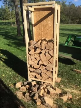

I'm about 1/3 thru cutting down 20 cords from 20" to 17". I built a rack that holds about 1/8 cord, which I load and then take one pass with a big bar on my 85cc saw. Makes the job about as painless as one can hope, but does generate mountains of saw chips and stubs.
Here's an early prototype of the rig, photo'd last October.
[Hearth.com] Cutting split wood to size
yea thats what I have in mind. Have you made any substantial changes from your prototype?
Only major change was dual front rails, capturing the bar from both sides, such that the saw can't wander off the cut.

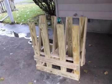

Here is a pic of the saw buck I built, works well for cutting branches or splits that are too long.
Make sure you use PT limber, ( the first one I build rotted and fell apart)
My stove has a small firebox ( 18"x12") seems like it will hold more wood NS than EW.
If I have a split that is longer than 18" I cut it in half and burn NS.
