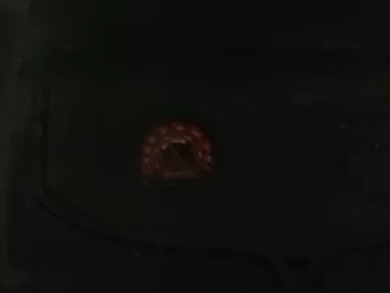

I've had a good experience with mine. My wife was just commenting today on what a good stove it's been for us over the past five heating seasons. Every person's stove/
chimney combo is a little different, so my cruising temps may not be exactly the same as yours. Your laser thermometer was a good idea. You'll notice as you play the
laser around the stovetop that the temps fluctuate quite a little bit depending on where you point. This ipod pic is a little dark and blurry, but you can get an idea where
I put my thermometer or point my laser thermometer for comparison. With the thermometer set there, I try to cruise between 550 and 650. I don't worry if I touch 700
for a few minutes, but I try to avoid 700. I'm at 400 on the thermometer now, but that's after cruising temps of several hours.
