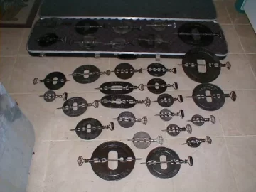

Yes it needs a damper. Back in the day, they had different size holes in the center, so when closed the "low burn" was simply closed fully. Watch eBay for a Griswold. You also have to realize when the stove was made, chimneys were shared and even had fireplaces in one room or on another floor, so as the heat rose from this stove, it would allow leaks into the flue from other sources cooling the draft and slowing it down.
Here's some of my damper collection showing the center hole you won't find in newer dampers today.
