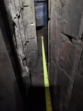

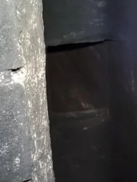

I went to the local dealer to grab some materials for a Jotul c450 install and couldn't escape without getting an installation spiel. The advice was that if I am using a complete flex liner from stove to roof cap that I don't need a block off plate and instead should stuff fiberglass insulation around the liner at the damper location(thats how they do it). If I do, I shouldn't seal it( I mentioned using silicone). Also, I should not install any insulation around the liner at chimney top, the reason being that the heat needs to escape from the chimney cavity around the liner. My liner is not insulated (flex king pro), and I planned on installing a block off plate, use mineral wool insulation, and to pack mineral wool around the liner at the chimney top. Am I off base? My logic was to intentionally trap heat in the chimney to get a better draft and keep the heat in the house. Would this somehow damage the chimney?
