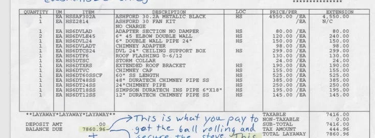

Hi, a local dealer came over last night and was measuring and gave his opinion where to put a wood stove. He recommended the Blaze King Ashford 30. It is alot of $$ installed. I dont know if im being ripped or not but it would cost approx. $8,900 installed. For the stove and parts came to $7,860 + $1,050 for install. Anyone have any feedback regarding Blaze king Ashford 30? Do you think this is a good price? I have no clue regarding all the pipes needed. But the pipe will go approx. 8ft straight up through the ceiling. Im not sure of the length after the asphalt shingles.

Stove and chimney prices have gone through the roof this season. This quote doesn't seem way out of line given what we have seen lately. However, I do question the chimney pipe listing. I'm not following why would one want to have those short pieces at the end of the estimate instead of one 3' or 4' piece. And why only 24" of stovepipe (DVL)?
Is there an attic above the installation location?
As far as the stove goes, it's a good one. Whether this is a good fit and value for the home and your needs is TBD. We know nothing about that side of the equation.

Hi, after seeing the estimate i thought the same thing. What is up with all the short pcs of pipe? The room that its going in has a shed style roof. I just measured and would need approx. 6ft of pipe going straight up to my drywall ceiling. Why would i need 2 pcs of 45's? Doesnt it just go straight up?? Also he states on the estimate "The main thing I want to point out is the quote includes more then enough pipe to do the job. Whatever isn't used is refunded to you upon completion of the job." Just wondering why he couldnt figure the proper amt of pipe to use when he was here??

The 45's would be if the stove pipe needs to shift over to go between the ceiling joists. the 24" piece would go in between those 45's. Seems like you're still missing 3'
