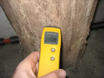

I got mine from some guy in Hong Kong who was selling them on eBay.
  • [Hearth.com] Decided to Buy a Moisture Meter
Keep in mind that moisture meters are of two types, pin and surface reading. The pin types often have different lengths of pins which your press or pound into the wood. Moisture is read between the pins. Is only accurate where the reading is taken, and does not read further depth into the wood. Very good for boards, might not be the best for logs. Surface reading can be scanned over the log to easily take readings at different locations, but accurate only 1-2" or so into the log. Coming in from both sides and you can get pretty accurate into a 4-5" log, beyond that not an accurate reading of log interior.
Surface type can be useful but like so many other things is a guide only. Best bet is to cut, split, stack and let wood dry 1 or more seasons. From other posts gassifiers do best on fairly dry wood (15-25% or so), and not as well on wetter wood. From personal experience mine does well on drier wood (10-15%) but the burn is hotter, which means adjusted draft control at least.
I think both types of meters have adjustment factors for the type of wood, ie, +/- reading depending on type of wood. Probably not too necessary to pay attention to this for normal heating purposes, but might be important for careful meaurement of performance purposes.
My moisture meter has the 2 pins (see my post under the Gear). If I am in doubt about a batch of wood, I resplit a few pieces and take the reading on the inside of the new splits. Sometimes even going so far as to drill a couple of tiny holes in which to insert the pins,little more work but it is accurate. So basically, re-splitting into smaller pieces and then testing seems to be the "key" if in serious doubt. Eric, I know what you mean, you can be burning wood from the same woodshed for weeks and weeks and then all-of-a-sudden, there appears to be some smouldering happpening with some of the pieces. Thats when it`s time for the good old moisture meter.

The cheapo meters are good for firewood. Even if they aren't that accurate as to the actual moisture content, they should be relatively consistent between readings. Once you establish what readings burn best, you just go from there.
