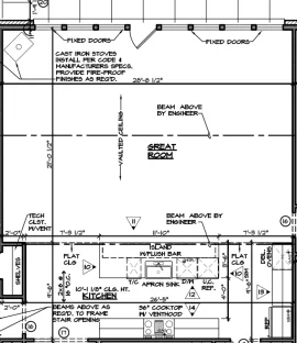

I've been a long time lurker and Im finally getting to the point where my project is about to start becoming reality. I need to make a choice between the two stoves and I wanted to get everyone's opinion...
Im going to be heating a 30x30 open concept room with 20 foot ceilings in 2/3rs and 10 foot in the last 1/3 over the kitchen. The house will be pretty efficient with foam insulation, likely will be brining in outside air to feed the stove. We are also in Texas so this will likely not be running full time but rather when its really cold outside in the low 30's or if we have a power outage.
See below for room layout...

Go to the Hearthstone and Vermont Castings forums for several user reports and questions on these stove. Personally, I would not choose either for a first stove.
If we did lose power and had to rely on one of these stoves to heat the common area, which one would be best?
The Heritage would probably be the easier stove to manage.
How different will the heat be with the soapstone?
The stove will be slower to warm up, but when the fire dies down, the stone will continue to release heat slowly into the room.
Cast iron jacketed, steel stoves have much the same soft heat effect, but warm up quicker and some designs are much simpler. This is a plus for a first-time stove owner. Are Jotul or Pacific Energy stoves sold in the area? If so, look at the Jotul F45 and Pacific Energy T5.
In order to operate well, any stove will need dry, fully seasoned firewood. Good hardwood like oak can take a year or two to season after it's been split.
If the great room has a cathedral ceiling, the peak is where the heated air will want to stay. It will take ceiling fans to circulate the air in order to maintain a more even room temp. They will not run in a power outage unless an alternate source of power is available for them.
