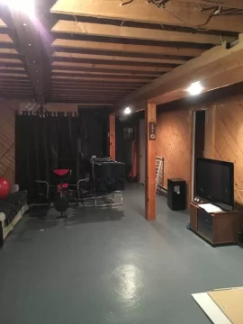

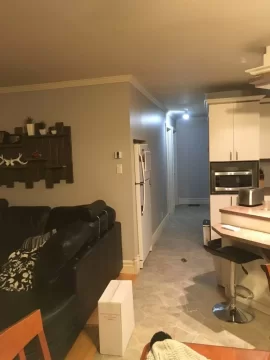

Sorry for the mess, took quick pictures. They are taken both near the staircase, at the two different floors.
At the end of the corridor there is the fresh air grille on the floor.
The stove is at the end of the pic. Only a small part behind the chimney isn't covered (bare concrete). The rest is gyproc and ?? insulation.
So, regarding all those elements. Knowing that I like to get comfort with the stove, but it isn't our main heating system (like a furnace, for example). Should I stick with a wood stove or i'm better to switch to a wood furnace even if the cost is much higher?
