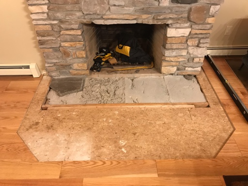

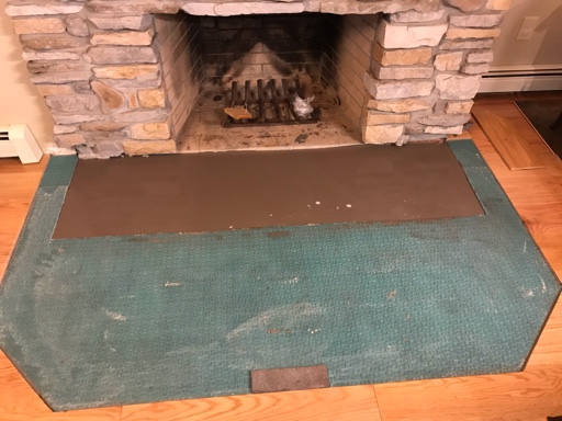

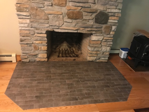

I used an uncoupling membrane when constructing my flush hearth. I have an Jotul Oslo which requires ember protection only. I have an uncoupling membrane which is on top of the subfloor via thinset mortar and then porcelain tile on top of that. The floor in front of the stove does get pretty hot to the touch but I doubt it’s hot enough to cause damage to the membrane which is sandwiched in mortar

Thanks. I'll look into that. It's beautiful btw. I love it.
