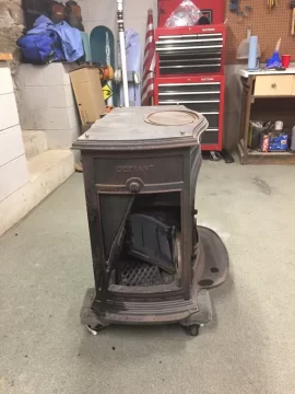

I was given an old Defiant by a family member who bought a house and does not burn wood. It was in fair shape (missing two doors plus some surface rust). After doing some research I confirmed that my fireback was cracked so I decided to take the whole thing apart and restore it from ground up. I've never restored a stove before so I am excited to learn as I go.
While taking it apart I noticed there was some mesh screen apparently installed in the secondary chamber between the fireback and the back wall. It looked like it was just above the holes that run along the lower portion of the fireback. I can't find anything that leads me to believe that was from the factory. Can anyone confirm?
So far i've managed to take it apart (without breaking anything) and started removing the old cement and surface rust.
Any tips or advice would be appreciated considering this is my first go at this.

!! That could be a deal breaker. Doors are no longer available. Also, at the time they were making this stove the holes for the hinge pins were drilled by hand I think as doors from one stove don't generally fit another stove. The hinge pin holes just don't line up. May have to punt, sorry.
