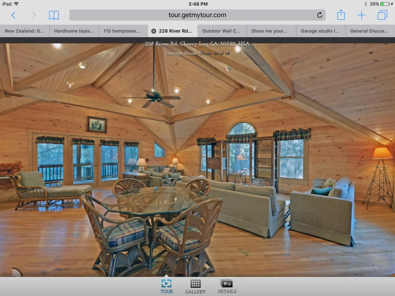

When we first bought the cabin I asked the kind folks here about adding a wood stove to this detached garage loft apartment. It will be used by my grown kids, guests, and Airbnb renters on occasion. Everyone here concluded that an actual wood burning stove wood be a huge maintenance issue, plus the space in question already has a propane hookup right where I want to put a stove. The thought was that most guests will find it easier to just flip a switch and not have to deal with wood. Plus I won’t have to clean it or haul wood up to the loft. If a guest wants to experience a fire, there is a fire pit by the river.
Here is the space with the previous owner’s furniture.
