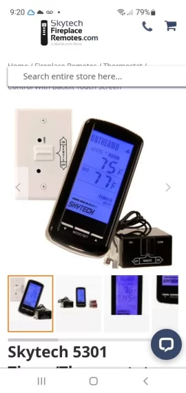

ther is a remote thermostat that you can program and set a temperature it will automatically go off

If there are ventless units with remote thermostats, I'm wondering if I might find one that has a timer function, such that it can lock out for a programmed period after a certain amount of usage. This might alleviate some of my concerns, with having a ventless unit going all night in a closed space, as not all of the kids are responsible to watch this manually.
Thanks, Woodsplitter! Will check it out.
