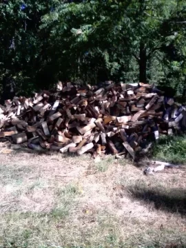

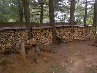

What up Jet, I run my stove between 500 and 700 all the time, and my electronic cat probe reads up to 2000
deg. sometimes. Maybe its my type of wood ---- mainly silver maple I'm using. I know that the wood is seasoned ok, it checks out to be 22% and under with a moisture meter in the middle after I split it open.
The Cat cruise rght around 1400 steady during most of the burn cycle, it can rise up to 2000 with a brand new load of wood then lowers when the wood is completely chared. It's pretty cool having an electronic cat probe, you can really monitor the burn cycles and cat light-off procedures...neat stuff... I was just thinking that maybe my draft was too good and causing alot of flyash to get sucked up into the "hood" and onto the cat. The fires I burn always have a nice dancing yellow flame un till the end of the cycle, when all that is left is blue flames. I do however have an inline flue damper that I can close back if I wish but I have never tried this, and don't really know if I every really needed to. Maybe I'll try some of the Oak I have for a while and see if the issue is resolved. I will not know this for at least 2 to 3 weeks and I'll will check the cat again at that time.
