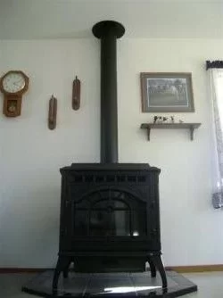

You know what your doing. Been at this game awhile. I dont care what anyone does. So long as "They" think they have checked everything and they think its safe enough to operate. Code or No Code. People will do what they will to get by. If anyone of ya'll ever came here you would have an "Ah Ha" moment and say "that little son of a %$*##". But having had a Fire in my home. I do not take some things lightly. (Like Candles - Only have one that we light on Special Occasions and Holidays).
My install aint perfect. My Quads OAK looks like I strangled it. I take pics from "Good Angles" so it looks better than it appears.
I dont believe I have ever seen pics of your set-up? I think I remember pics of the Englander not to long ago. But the Vernon???

Sorry Brad.
  • [Hearth.com] Distance between OAK and LP Tank
^^^ Very Nice ^^^… Love that pipe. Selkirk DT on both installs. Nice.
Yep... Sorry Brad.
